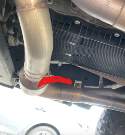

Awesome man, appreciate it. I think I'm gonna run two of these (whichever one lines up the best per exhaust shop), then get them to do a reducer to 2.5 after the muffler, out to my 5" tips. Should be a pretty nice setup when complete! Are those Thuren Kings I see under there? 1746280742730.png

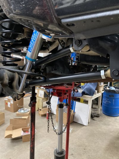

No problem! Yes on the thuren/kings, they are stage 2, supposed to be double stock + 10%.
I have a set of Bilsteen’s I used while having them rebuilt, nothing bad to say about them, but not as firm as the kings.

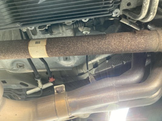

Hey Adam, I need to get a **** for my AFR gauge welded in this section between the collector and the cat and I'm wanting to get it done before I start the install. Is there plenty of room on the topside there for O2 sensor clearance?

Should be lots of room to mount it in that area,but before hand, crawl under your truck and eyeball it up,while imagining roughly where the headers and midpipe are going to go. That's roughly where i had mine mounted.

I did crawl under there, and eyeballed it best I could, but without knowing the exact line of the headers, it was hard to gauge. It LOOKS like anywhere from 10-2 (o’clock) just before that bend would clear fine, but just wanted fo double check.

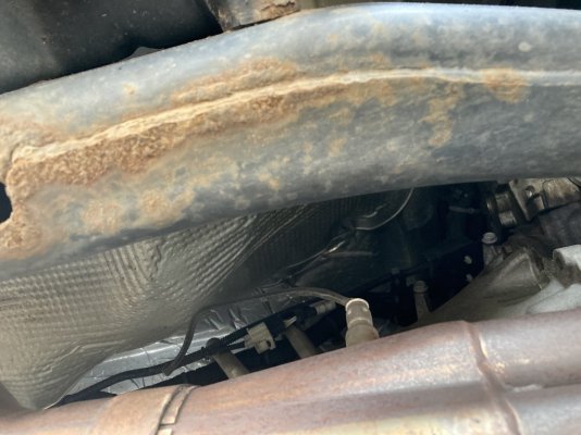

There is a lot of space, at least on my truck, got a couple pic’s front & rear but looks like you only need the front.
