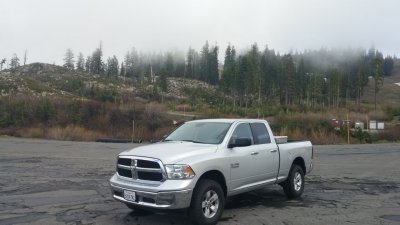

I am using 2.5 spacers. The truck drives like stock, i noticed ABSOLUTELY no difference. I dont understand why everyone says there ****.
Here is it right after i got it done
After i added air bags
