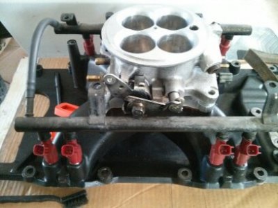

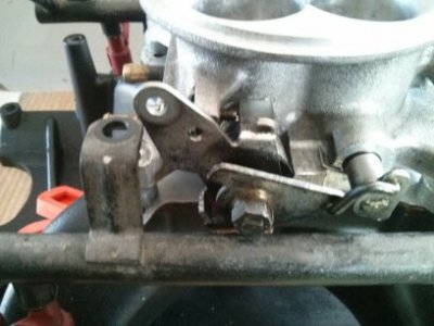

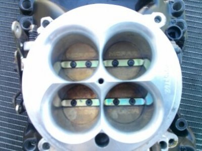

Heres what I,m going to use on my truck . I am just getting started on mounting the throttle cable and tv cable. Then I need some custom fuel rails. 1505422029983.jpg 1506019591896.jpg

Heres what I,m going to use on my truck . I am just getting started on mounting the throttle cable and tv cable. Then I need some custom fuel rails. View attachment 150074 View attachment 150075
Nice. That looks like a Speedmaster or Holley setup, prob 1000cfm. I picked up a Holley 1000cfm myself. Less total airflow than i could've gotten from an f&b 58mm throttle body for the 2bbl m1 and porting the neck to fit but the 4bbl setup clears better even if you have like a 1 inch spacer for a better entry angle.
The difficult part is the cable setup for them though. I got lucky and got in on Todd Ognibene's sale of 4bbl throttle brackets. That should make it significantly easier for me

Its all Mopar parts I have here. Who is this Todd Ognibene you speak of.The cable setup is the only thing stopping my install. I have it mocked up on the bench now, as you can see the fuel rails interfere with the lincage. Also a 1/2" spacer will work fine. Its the mounting tabs on the rails that are causing me greif. 2 of them are in the wrong spot to secure them down. I may be able to cut them off and tig weld them back on. And a Merry Christmas to all.
One of the Dakota RT guys. He's the guy who made my blower brackets as well. Had his local machine shop do a run of em.
Im going to be using Hipotek rails so i shouldn't have much of a problem with contact either
