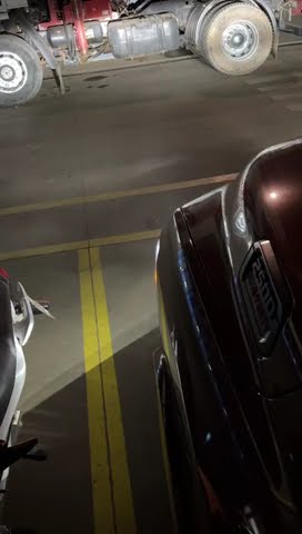

My dear friends, I have already replaced the air filter with the original one, it is indeed a viscous clutch, I apologize for the mistake. About the tuner, I asked him and he told me there was no change in the ventilation system. I’ll upload a YouTube video so you can hear how it sounds. In the video, the truck had just been started, it was partially cold after being off for 2 hours, and right after I started it, I recorded the video with the A/C on. It’s important to point out that if I start it with the key, it behaves the same way, since the A/C turns on as well."

As you have been told in other forums what your hearing sounds normal to me and many others also agree in the other forum you posted this same question too
