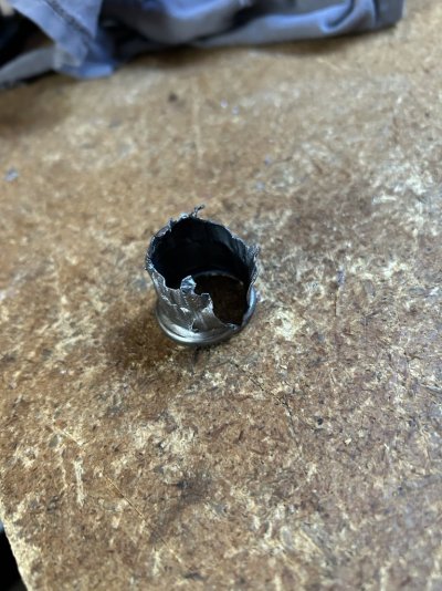

I just had hell of a time taking one off. Had to get the cap off with some “alternative methods”. The rest are swelling and bought some solid one from Dorman. Hope to get them swapped out this weekend.
