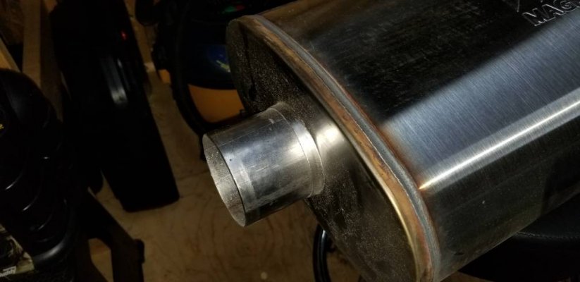

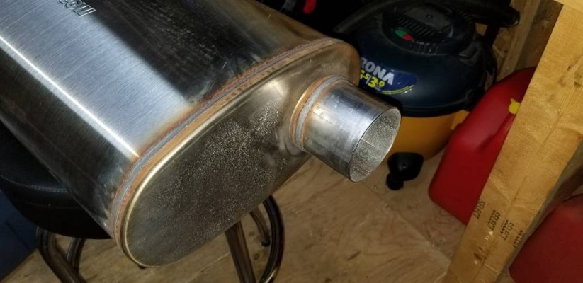

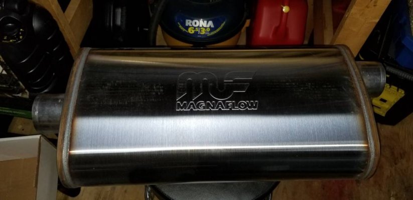

I noticed that on my new muffler one side is not welded, at first I thought it was normal but now I don't think so since my previous magnaflow were all welded.
Normal? dd8f5d77dff87ff7b91e62594652e1b0.jpgb518c6c80ce481514d217ba7d7c00d7b.jpgb589871956571f86578bf05b35975d26.jpg

Probably not right...why would they weld one side and not the other? That would be my guess..

That looks like a “whoops” - call em I am sure they will send a new one.

Well got my replacement today and same thing so I decided to call and apparently they now sometime only press fit the pipe and "weld" it from the inside.
As you can see there's only a small weld on the inside(one on each side)
I'll have it installed, but this is not the quality I was expecting from magnaflow. Unfortunately there's not many companies that make a free flowing muffler of this size...
