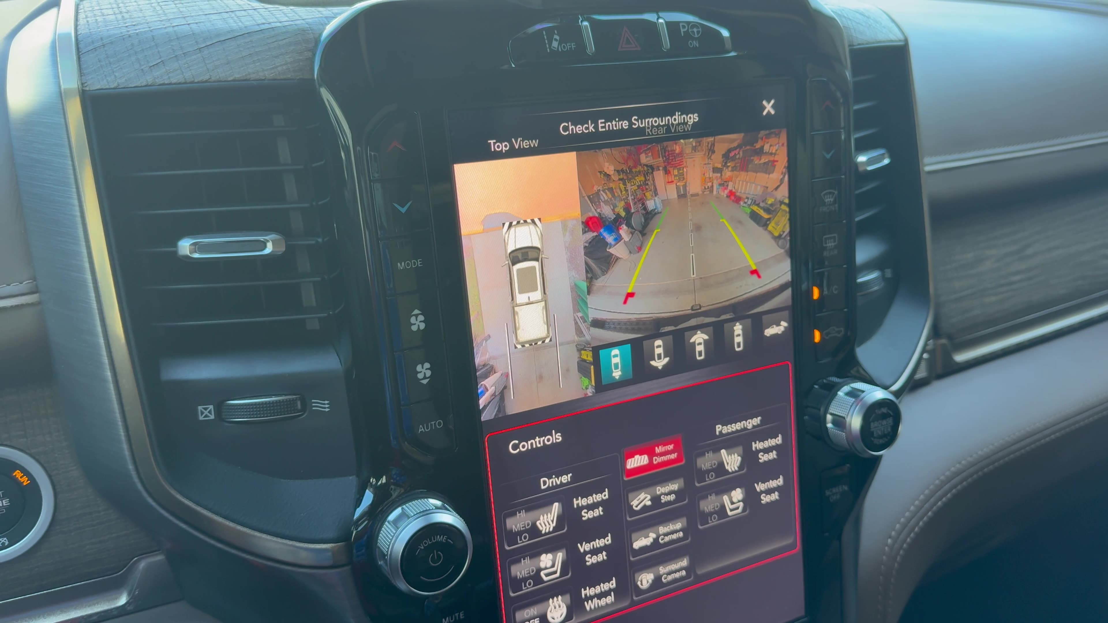

You are wrong. I have a Tazer DT in my truck and when I activate my turn signal I get the back or front camera (my choice on which to display after it’s activated) and it shows the surround view at the same time.
The same camera view selection screen that allows you to cycle through all the different cameras comes on with my turn signal and when the parking sensors senses something close to the front or rear of my truck.

Comes on as soon as I activate the turn signals so it pretty quick and goes away when the turn signal turns off. I will take a video tomorrow and post.

I posted the video on Rumble. Here you go.
That's way faster than what I saw with Naviks. If they come out with the same for my year 2500, I'd buy it for sure.
Thanks for taking the time to post it, I appreciate it.

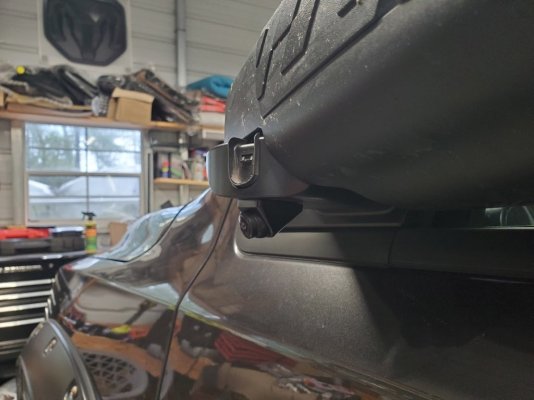

I have a Naviks box...and installed after market cameras under my side mirror...when I turn on the turn signals, the image is instantly displayed on my Uconnect 5 display...I don't have a PW but this solution works on my 2022 1500 Lone Star.
