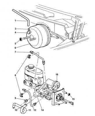

On a 2500 may use a hydroboost for the brake booster. It maybe power steering fluid that's leaking. I stated maybe as there was some years that the gas trucks were built with either vacuum or hydroboost.

For reference in the picture, the top is the vacuum booster and on the bottom is the hydroboost(has master cylinder attached).
had a brain fart about the power steering fluid being red. Hard to say if it's residual brake fluid that leaked into the booster that's working its way out?brakeboosters.jpg
