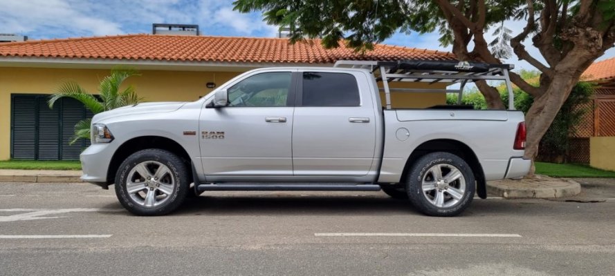

Hi,
I know there's a lot of info about Bilsteins. Sorry if someone already post that.
What I'm currently planning on a budget.
Front Bilstein 5100 2.1 level (with stock uca) that's my concern
Rear all stock with a 1.5 spacer.
Planning later on to install on the rear.
I appreciate your feedback,
Thank you,
Pedro
