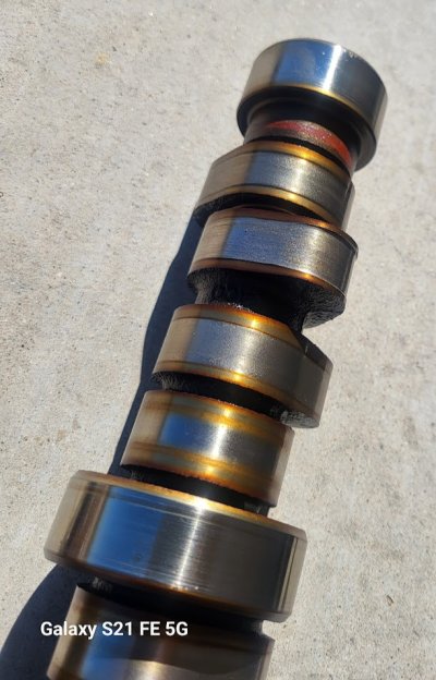

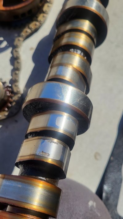

Tucson AZ
Mine had one lobe going south. But several others were not going to be far behind.
And only one lifter roller bad on worst cam lobe .
All the others felt fine

SD2020
Oct 4, 2023
22
Canada
Ya my number 3 was toast, but all the rest were showing problems as well.

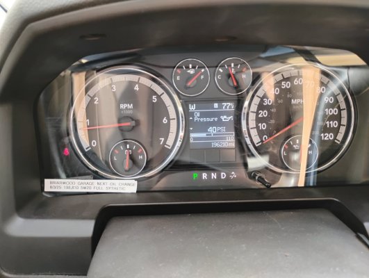

MrCody Yellow Lab
Jun 13, 2024
Washington State
I put magnetic drain plugs on my Charger and Ram, the charger was full of this metal paste! hot oil pressure on it , is 47 at idle and 53 running above 2,000 rpm's! Replaced with stock oil pump , and VVT , both had scratches! Ram idles at 51 and 54! My Charger had MDS, all automatics had that system, Manuals did not! Same horsepower as all the other 5.7's , except the police car was governed to 150 mph, while everything else is governed at 130
