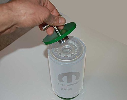

I use an Oil Filter Plug with a T-handle. Pretty simple to use, and I've got pretty big hands.

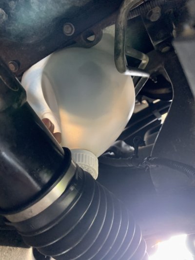

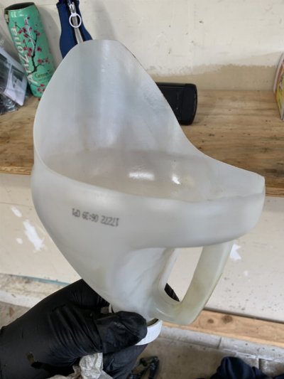

Since they decided to put the oil filter in a horrible place and it makes a mess every time I took it off, I decided to do something about it. Took a windshield washer fluid jug and cut to contour the filter/space the filter occupies. Fits perfectly and still leaves room to spin the filter off by hand. With careful maneuvering due to the tight spaces there is no mess left behind. I know I sound like an infomercial but give it a shot. It works wonders!!!

I love this idea... would it work better if you cut off the top part instead of the bottom? reason I'm asking is that youd have to hold that up with one hand.. if it had a flat bottom you could just let it rest there, or does this somehow wedge itself in so you don't have to hold it?
I found the top to have a little more stability and having the handle there is a big plus. And the handle fits perfectly between the rack and crossmember. The cap allows it to balance in there without tipping over so you can concentrate on getting the filter out after unscrewing it all the way. If I get time tonight or tomorrow I’ll try and get some mock up pictures of how I used it to help aid others to understand the concept a little better.

Ok here we go, remember it’s just for mock up purposes since I’ve already done the oil change. You’ll still get some drips of oil so keep a rag handy. It catches 99% of the oil.
Here is the start, angle it inwards and still has plenty of room to spare
The rear angle, shows how it covers the entire spill zone
Able to wedge/balance it between the rack and front crossmember
With it being wedged in place, it allows the filter to be removed while any extra oil will still drip into the container
Here’s how the high back left on the container still continues to catch any extra oil while being removed
These show that with the filter removed the container can be easily removed while keeping the contents from spilling out

Awesome thanks for the pics! I'll be making one of these as soon as I have an empty washer fluid jug[emoji106]

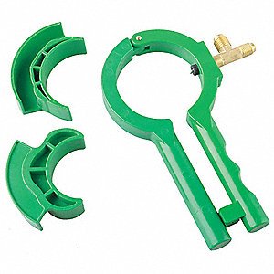

I wish someone made a tap clamp that had tubing to drain the filter to a container sort of like a side tap valve used on A/C refrigerant cans. On our 4Runner it uses a canister filter that has a drain plug and tubing adapter to drain all of the oil out before you unscrew it. Lots of access beneath it but you have to remove a massive skid plate.
