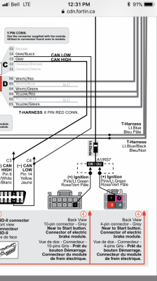

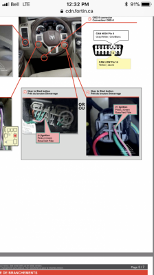

So there is at least two places for the ignition source according to Fortin install guide .
They are both the same colour wire so I wonder if the meet at the same point down the body harness .
Where did you get the ignition source currently ?
I would maybe disconnect the battery and do a continuity test on the two wires and see if they tire together .
