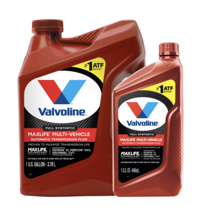

Is this the Valvoline product discussed as good alternative to Mopar ATF?
My self would not use it, they make an ATF 4+ trans fluid, I'm not one to try any ATF that does not list ATF 4+ on the front label, at this time the only AFT I would use that is listed as multi vehicle is Amsoil as I used it on my 06...

Your '06 had a vastly different transmission.

I bought 2 jugs of the Valvoline Max life ATF this morning…4 bags of Valvoline 75-90. I just changed front and rear diff fluid. Truck is at 80k. Both old fluids very much same color as the new oil that went in. Front diff had a teeny piece/flake of metal but otherwise no chunks lol.
Went to do the T-case and checked my fluid pump, it was cracked. So I summoned Amazon fora new pump. Will wait and do it when my ZF pan gasket arrives. Thanks for that link @Wild one
