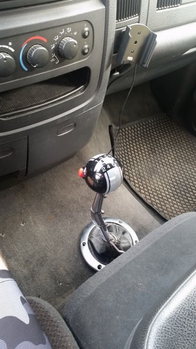

A carbd 360 stroked to 408 or 410. Electric water pump the whole kit. To a 727 to a 3.92 rear from a ram. Gets fed 100 low lead in the fuel cell in the back.
Basically a street tire burning machine lol
And yes the dash is customized and a floor shifter
So yes you should definitely do what you are thinking of :favorites13:
