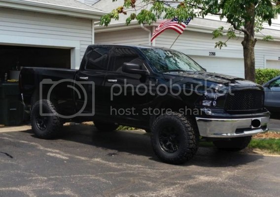

Here is my truck with a 2.5 front level 1.5 inch rear spacer and a 3" body lift. I love it.
Looks good man, you put the spacer in the back to keep the rake?

4.7
Yeah I don't mind a slight rake it is very minimal when parked flat. I might remove it sometime just don't have the time.
