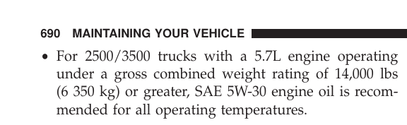

Couple points you may want to consider: it's not about the engineers not knowing better, they have to listen to corporate demands and fuel efficiency is a big one. Fuel efficiency has been driving thinner oils, that's it. Ask any tribologist and they'll say the same thing.
And secondly, the 6.4 hemi recommends 0w-40 (and other examples can be found, engines sold in different countries). They have thicker oil recommendations for a reason. Some manuals even say, if you track your car or tow heavy, run the thicker oil. It's not too hard to figure out why they do this.
The hemi doesn't have a problem with flow. There is no evidence to suggest this. And if there is a problem with flow running 5w-30 at 200F, there is definitely going to be a catastrophic problem running 5w-20 at 50F.
Finally: the manuals used to recommend running 5w-30 in the 5.7 2500's. Right there in black and white. You will absolutely not harm your engine doing this, many of us have even run 0w-40 and for me the one time I did it was one of my best UOA reports.

There is a big difference there in 5w-20 vs 5w-30, many don't want to run an HT/HS < 2.8 or even 3. The second the film fails to separate the physical bits you're relying on anti-wear ingredients instead. At zero degrees (cold temps) the winter rating of "5w" defines how thick it is, both 5w-20 and 5w-30 should provide the same result.
The 2500 manual doesn't recommend 5w-30 due to temporary unavailability, but due to heat and workload. If you're working your truck hard then they tell you to run the thicker oil.
Okay. I thought we were addressing 1500s only. I was thinking the 5W-30 usage in 1500s was worded differently. In the case of a 2500-3500, I agree this probably makes sense.
