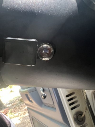

Can anyone tell me what this light bulb is used for on the steering column? I was seeing a short to ground through the #11 fuse. After I unplugged this bulb I lost that short. So I’m guessing what ever is telling this to turn on must be burnt out.
1989 Dodge w100 318

When you open the door it turns on to help you see where the key inserts in the switch.

0084F629-4296-4547-A21D-4030B13ED27E.jpegIt has a cover that covers up 99% of the bulb and has a very small slit. If it’s for the key, what tells it to turn on?
