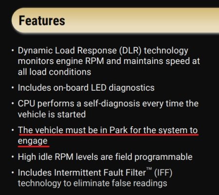

RamDiver
Jan 23, 2022
5,594
11,798
Marlborough, Ontario Canada
2021 DS
These guys make the high idle kits you are looking for.
Standard kit includes single OBDII datalink harness
Ram 1500, 3.6L Engine (2017-2019)
  • E-AFIS706VSX-BP | Up to 3 programmable speeds; AC auto trigger off
  • E-AFIS707VSX-BP | 1 programmable speed; AC auto trigger on
Ram 2500-5500, 5.7L Hemi Engine (2015-2017)
  • A-AFIS706VSX-B | Up to 3 programmable speeds; AC auto trigger off
Ram 2500-5500, 6.4L/6.7L Engine (2013-2017)
  • A-AFIS707VSX-B | 1 programmable speed; AC auto trigger on
Ram 2500-5500, 6.4L Engine (2018-2022)
Ram 2500-5500, 6.7L Engine (2018-2024)
Ram ProMaster, 3.6L Gas Engine (2013-2019)
  • A-AFIS730VSX-B | Up to 3 programmable speeds; AC auto trigger off
  • A-AFIS732VSX-B | 1 programmable speed; AC auto trigger on
Ram ProMaster, 3.6L Gas Engine (2020-2021)
  • C-AFIS730VSX-BP | Up to 3 programmable speeds; AC auto trigger off
  • C-AFIS732VSX-BP | 1 programmable speed; AC auto trigger on
Ram ProMaster, 3.6L Gas Engine (2022)
  • C-AFIS733VSX-BP | Up to 3 programmable speeds; AC auto trigger off
  • C-AFIS734VSX-BP | 1 programmable speed; AC auto trigger on
That looks interesting, and I understand the use for the product, but I don't appreciate this feature.
I want to tweak the low rpm to about 750 in all gears, not just Park.

All the Diesels will do it, no matter what configuration of cab, box or Chassis. My understanding is the same as yours that for the 6.4 it only exists in the cab and chassis ones. Mine does NOT idle up doing that, I tried it quite a while ago. I was thinking in terms of winch draw, so that is when I found the guys I posted above. Never did move forward as I don't idle my pickup all that much and the few times I need to winch hard, it is easy enough to idle the motor up with the foot feed.
