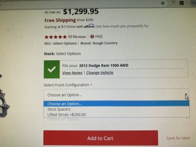

So I’ve recently put a 6 in RC lift on my truck and theres just not quite enough clearance for the tires I’m running (37’s). I’ve decided to just buy the 2in front strut spacers to give it that little extra lift that it needs in that front but not sure what to do to the rear end? Is it gonna be a significant difference in height between the front and rear end and if so what can I do to fix it without having to buy coil spring spacers? (Also lifting it bc my wheel set up is extremely aggressive, currently running 22x14 -76 offset with 37x13.50 tires)

Did your kit come with the extended length front struts or spacers?

Not sure what you mean? Like An adjustable length on the lift itself like Mcgaughys or are you asking if it came with the aftermarket front struts for the lift
First off I’m going to assume you have a 4x4 1500 (you didn’t specify). They have options with this kit for longer extended length front struts or just a spacer on top. If you have the kit with longer struts you can add a spacer, however if you have the kit with a top spacer you cannot add an additional 2” top spacer, only a preload spacer.
