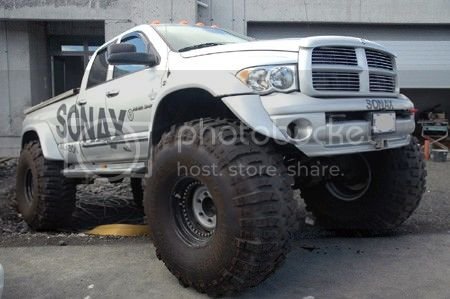

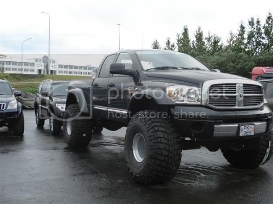

Pix man! wheres the pix? i want to see these 43" inch tires...Look up Arctic trucks and see if you get any ideas...

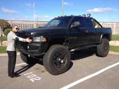

This is the best picture I have right now. She's tucked into storage for now. As you can she's rough around the edges because I'm still working on getting things to fit. But you see how I had to cut off the bottom of the front fender to get those wheels to have enough clearance?

I'm aware of how ice landers run thier rigs, we used to have a couple that posted on another forum I'm on...years ago. I can't remember if it's thier lift laws or what the reason is. It's a good idea becuse it keeps the CG low.
I'm not into hacking away stuff unless it's for wheel tubs or absolutely nessesary...and then I still try to do something else or utilize products avalible that minimize or eliminate the need. Sadly those trucks would never work in some the places I used to go.
