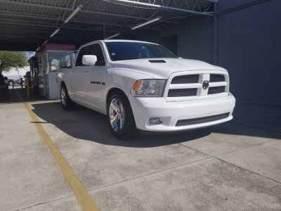

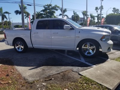

hi y'all I got a 2011 hemi 5.7 sport. the truck came lower, the front tires are not straight the dealer installed new tires 275 all around and the front wheels are the same, I dont know if I should take it to get aligned. I get on the highway 85 mph without a problem.
Man that truck looks great...I wonder how low you are?

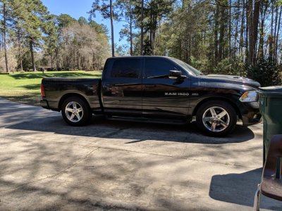

Well I finally got everything ordered and ended up putting a McGaughys 2/4 with helpers on my truck. I ended up cutting 1 coil out of the rear and adding an adjustable panhard bar. I love how it rides and love the stance. In some of the pictures there is no air in the helpers so it looks a little low in the rear. I am still trying to figure out how much air I want to keep in the helpers and such.
IMG_20180304_115402.jpg IMG_20180316_173442.jpg IMG_20180319_080122.jpg IMG_20180319_080152.jpg

Well it has been a minute since I posted so here are the newest pictures (excuse how dirty it is, the wheels got put on yesterday and it has rained non stop)
Ended up going with Illicit brackets to recenter the rear axle, SRT 22" wheels with 305/45R22 tires. I still have to debadge, and I have black headlights to be swapped in.
