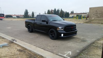

So I have a 4x2 2014 ram black express and I currently purchased a 2 inch leveling kit to make the beast look all leveled. I also purchased 1.5 inch spacers for my 20x9 wheels so they can stick out more.Im sticking with my stocks for now. Question is can I run a 35x12.5r20 tire or will it Not fit?
Pictures is currently lowered but it will have stock suspension and 2 inch spacer this week.

Everyone saying a level and 35s will fit without rubbing. You could always go with a 6inch suspension lift if you do though. :)

With only a 2" level and the 1.5" wheel spacers you'll rub for sure. If you don't want any rubbing you'll need more front end lift and smaller wheel spacers. Typically for a 35x12.5 tire you want at least 2.5" of front end lift. A 20x9 +19 offset wheel (stock) with a 1.5" wheel spacer equates to a 20x9 -19 offset. I ran 20x9 -12 offset with 35x12.5 Toyo MT's and a 2.5" level on my old 1500 and had a slight amount of rubbing on the back of the inner fender with those already. Your rubbing would be quite a bit worse. You could make it fit with some trimming if you really wanted to go with that setup.

With only a 2" level I would have to agree with about on going with a 33x12.5 or a 295/60 tire.

These are 18x9 0 offset. 295 70r18. Which is like 34.2 x 11.7 all I have is bilsteins at 2.1. No rubbing.
