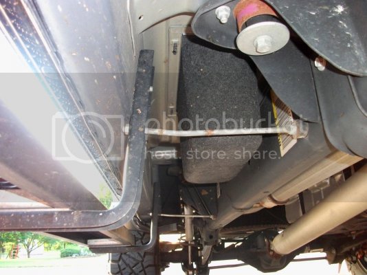

Just use stainless ready rod
Drilling in tap bolts into frame and drill through brackets towards the bottom , 5/16 rods are probably plenty

Got a pic of what the "ready Rod" looks like?

??? frame rail to Nerf bracket, to to easy ....
Basically putting in a rod to stop the lever that is the bracket from moving
