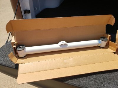

Ive seen many post on varying rear control arms for lifted, regular, lowered trucks. Core being a top favorite among most.
Well I reached out to Apoc Industries, and had them make me a custom set of upper and lower rear control arms. Yes, they are adjustable, HEAVY duty with grease certs, and the rear brake plate to put factory brake lines on.
AND, I had them powder coat them PW7, or Bright white to match the truck. They came in today, and wow!!!!
I cant wait to get these on!!! Will match the truck perfectly!
Hats off to Apoc Industries in TN!!!
Will match the Core rear panhard bar I purchased from @Booms

Those are HOT ! :D
I like the thingy for the brake lines too, the Cores do not have those.
Yes I asked about that, they stated even though pics dont show it, on Ram control arms they add them.
These guys have been outstanding all the way through the build.
https://apocindustries.com/
I wish our trucks up here in Canada were able to stay spotless underneath like yours! So jealous!!
