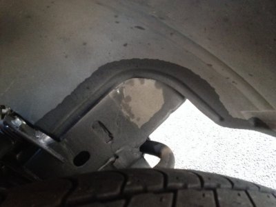

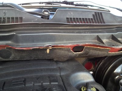

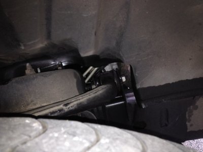

I thought I'd post some pics of the stellar job the dealer's "A" mechanic did installing the new engine... Enjoy!

A few more just for laughs! Notice how they crushed the transmission & oil pans! Love the grease stains on the floor mat too!
Oh and after all of this, just to add insult to injury. They had the truck for 31 days straight and they never replaced my mirror. They ordered it but it was sitting in a box in my back seat.
Just total schmucks!

So are they going to do anything about the damage to the pan or the interior? I can't stand half assin' mechanics. When I worked in a garage, every cars interior we covered the seat and floor to keep from tracking oil into the car. I don't know anyone that would call that acceptable. People just don't take pride in their work anymore these days.
They bought the truck back from me so its not my problem anymore. But for the sake of the new owner I certainly hope they made those repairs! My father was a mechanic for over 20 years and he was beside himself when I showed him those photos.
