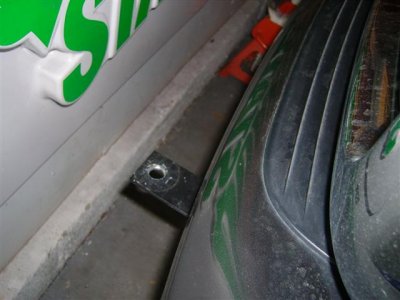

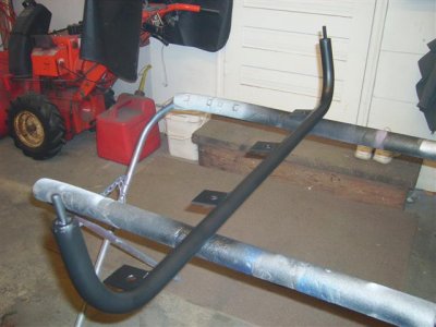

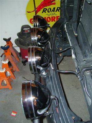

I started by making 2 L brackets that bolt to one of the tow hook bolts. Then I went to a Tube shop and had the pipe bent. That they charged me $20 for the pipe and bending it. (You could also use an Exhaust shop for this also.) When I got home I welded bolts to a washer and then welded them to the bottom of the pipe so I could bolt it to the L brackets already on the truck. Then I added the 4 tabs that I made from scrap around the garage. I sanded it and painted it then mounted it to the truck and added the lights. They were the only expensive part of the install!

Ha Ha..........they do light up the bark back roads at night pretty good! I don't think many deer are going to sneak out on me. I'm paranoid of hitting them.
