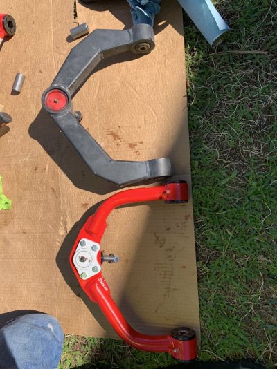

I had zone but found out that to much off-road flexing can tear the rubber bushing. Hence why I swapped to a free floating poly bushing type UCA like the jba or icons. The jba add caster. Nothing against zone. They were good.
