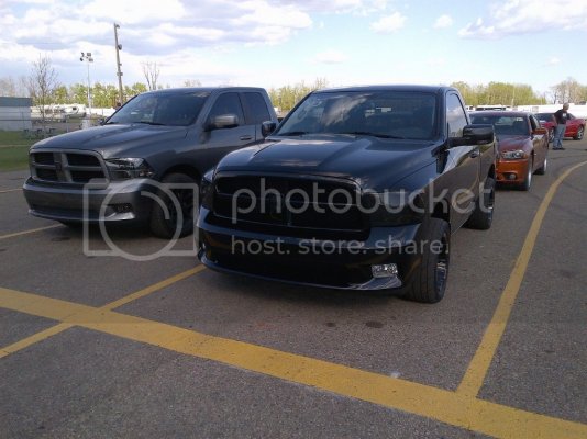

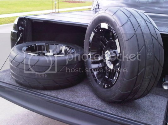

BlackRamHemi
Aug 14, 2013
1,266
558
Edmonton Alberta Canada
2010
17's front and back
I dropped 5 tenths off my ET's with these on all 4 corners (4x4)
Moto Metal 951's, 17" x 9" -12 offset
Mickey Thompson ET Street DR's 295/45R17
Went from 14.3's to 13.8's at 2500' DA (13.4 corrected)
(RCSB 4x4, 3.55's, intake, catback, Diablo 93 canned tune)

BlackRamHemi
Aug 14, 2013
1,266
558
2010
I use to run that same tire and size on my 2012 mustang gt. They're pretty expensive.
I thought they were a bargain at $199 ea compared to my old street tires
Nitto Terra Grapplers are over $420 for 305/50R20's in Canada.
They don't require a massive burn out to heat them up so they will last forever.
Mine are 4 years old now and still look like new, made about 100 passes per season on them.
I chose tires and wheels for lighter weight, better grip,
and effective gear ratio drop from 3.55 to about 4.20:1
A gear swap would have cost me over twice as much as tires/wheels.
