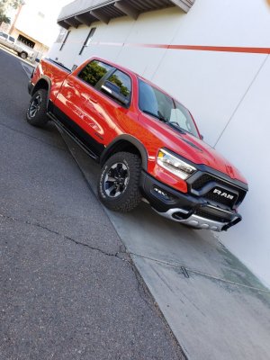

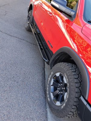

(To clarify, I saw your Facebook post with additional under-carriage shots) It’s clean, for sure, but with cost cutting comes sacrifices. With the extensions being welded directly to the frame with no additional reinforcement plates (like the competitors you mentioned have), that’s a ton (or more specifically, four tons) of downward stress being put onto those welds in the event of a hard downward impact. That’s a lot. And if they fail, they’re going to rip quite violently out of the frame. The clamp on style is much stronger, evening the stress of flexing across the entire height of the frame instead of just on one 2” square. I’m not saying these WILL fail because obviously they’re custom and not a lot of data to go off of. Just in my personal opinion I don’t think they look as strong as a frame-mounted clamp on style with reinforcement plates, and I’d want as much strength as possible.
I see your point about the weight, the fab guy builds rock crawlers, rock buggies and about anything else that goes fast. I talked with him about those points and he felt that what he builds is just as good or stronger. PWIM will be a good test i think......if it doesn't survive i see a 2021 model in my future. (the savings on price comes mainly from not paying shipping costs) These are stout.

Hopefully i won't have any issues, if i do then i guess i will have to make some changes to it.
It appears that they ride right up to the pinch weld on the body so if you do flex and the gap is less in one inch, the pinch weld will hold it from going any further. I like it. As it looks like it is higher then your skid plate so you don’t lose any ground clearance. And if you had the factory tube steps like I did, you gain clearance with you new setup.
