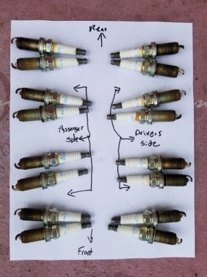

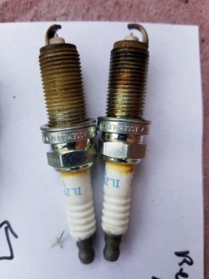

The gaps look huge. Should see some power back if you were experiencing spark blow out

Thanks for taking the time to put those pics up. Neat to look at it after 180K miles. They all look about the same color.
