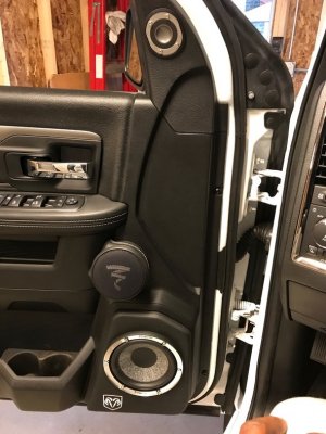

I took out the KRX3 3way set and upgraded to the Utopia be No 7 active kit. These are some of the best speakers I have heard. The musical reproduction is amazing. The pod in the pic is where I originally put the mid but found the dash to be the proper place for imaging.

Beautiful. I love focal speakers. Ill have to upgrade from my ps165s

Beautiful work! Always loved Focal and the Be is amazing.

Looks awesome and sure it sounds great as well :)

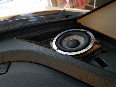

I have a passive 3 way focal setup similar to yours. I have the 3-way focal access. I, like you, ended up mounting the mid in the dash however I could not get the stock grill to fit over the speaker in the hole. I ended up making a new dash plate and have the speaker sitting on top. I was wondering if you are using the oem grill and what you did to the dash to get it to fit.

^^^what I ended up doing is making a mount out of 1/4 inch MDF, i used the factory dash speaker frame as a template for making the mount. It's tideous work but gave my the result I wanted. With the new mount all I had to do was angle the grill up a little higher and wiggle the tabs through the holes. It was a little tight but worked out fine.
