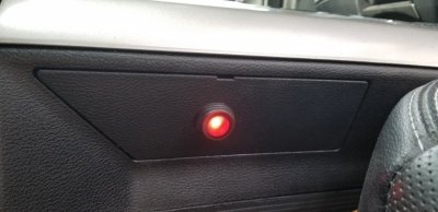

20190722_180420.jpg 20190722_180354.jpg I found this great little spot on the side of the console. Very easy to route wires to and if you ever change your mind, cheap to replace. Switches are easy to reach but out of the way enough not to bump. There is probably room for about 4 switches. Wires can go through a cover in the firewall by the steering shaft.

The side of the console (for those who have one) is a good spot for ease of wiring and ease of de-installation. The nice thing is that it keeps the dash clear. But it's not as accessible without taking eyes off the road or working by feel, so for frequent, safe on-road use the dash mounted switch pods are nice.
