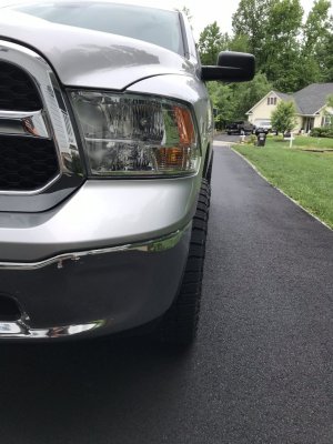

I know, not another wheel/tire size thread....but I've researched myself into confusion and hoping to get some clarification.
My 1500 4x4 is leveled (with a tad of rake) with Bils set at 2.1....nothing in the rear. I have a Bighorn with stock 20x8 chrome clad wheels. I bought new wheels with -12 offset that are 17x9 (I'm kinda old school). I think my stockers are +19 offset. I also will be installing pocket flares that stick out about 2" and want to make sure the tire size (width) I select sticks out just the right amount....1.5"-1.75" from stock.
I'm looking at either Nitto Terra Grap G2 or Ridge Grap as my new tire. I'm trying to decide on the following sizes. 285/75/r17 (34"), 295/70/r17 (33"), or 305/70/r17 (34").
Here's where I get confused....how far will each tire stick out compared to stock? The +19 to -12 offset should net about a 1.22" difference, so new wheels stick out farther. I want the tires to stick out a total of about 1.5'-1.75" from stock so they are still under the new flares which will stick out about 2" (EGR pocket flares). I don't really like too wide a tire (12.5+) so I'm trying to stay in the range above. I think 34" tall is a large as I'd like to go without a proper lift.
My preference is 285/75, but I'm calculating it will stick out about 1.4" and not sure if it will be quite enough. The 305/70 will stick out about 1.8" I think? This may be too wide a look for me. The 295/70 is between the two, but it's only 33". Am I correct with my calculations? Any issues with rubbing with any of these sizes? If I'm off, please let me know what the correct numbers should be.
