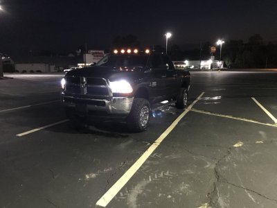

I have a 2018 2500 with quad headlights that were terrible from factory. I bought led bulbs from headlightexperts.com and I couldn’t be happier! The bulbs are designed to be used with the reflector headlights so they keep the shape of the factory beam but WAYYY brighter. They have kits for your projector headlights also. I just couldn’t get myself to spend over a grand on headlights so I put $200 into the bulbs. I live in the country so I had to have better headlights.
