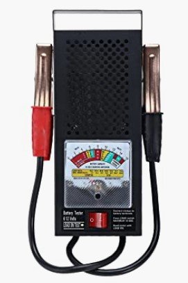

All batteries, new or otherwise are an unknown variable until load tested.
Take the battery to an auto parts store for a load test, most will check it for free.
Or, the better solution is to buy your own toaster-style battery load tester.
They're only about $20 and far more reliable than a digital tester.
I enjoy the convenience of owning most of my own test gear.
The above picture is for reference only.
