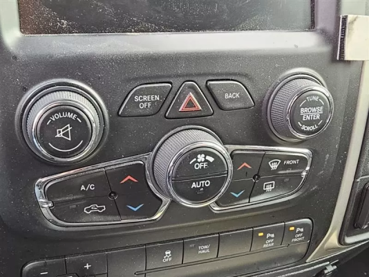

Now you can remove the surround around the Radio
There are plenty of YouTube Videos on either type of Console your Ram has
There are 2 more actuators below the HVAC Controls
Follow the Actuator & Door Instructions as written above
