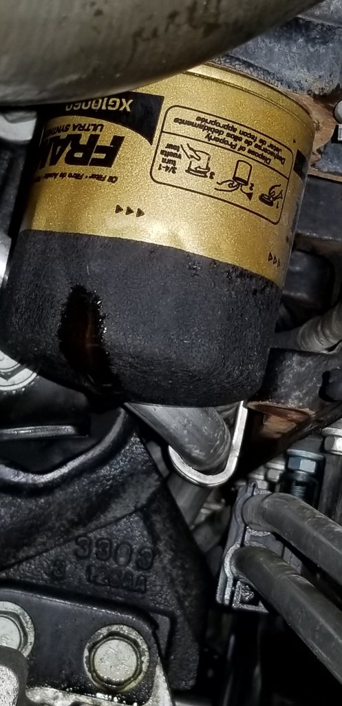

Noticed a darker then usual wet spot in driveway for maybe a week...I assumed just condensate from the A/C. Wrong...oil, a little more everyday. Finally checked the oil level and it was below the dipstick. Thankfully I didn't lose oil pressure...after topping off with some spare oil I picked up my 7 quarts and new filter and made it safely home. Now to locate the leak a can of brake cleaner later I started the engine and found my oil filter which was a little past 4000 miles or 50% per computer life was leaking through the case. Was it hit by a rock, manufacturer defect I'll never know?
Anyone experience similar issues, either manufacturer or a specific reason for failure?

Yes. Had a similar experience before the first official oil change at the dealer. I think it was April or early May 2018. Had a drop of oil on the driveway. Didn’t believe it could be a leak...but it was. Had a long ish road trip planned in a week stopped at the dealer to have them at least have a look. . Bingo, they found a crease/crack in the original OEM oil filter. Changed under warranty and topped up the level. No idea how or why it happened.
2018 4x4 Sport Crew Cab 5.7 Hemi btw.

I haven't seen this either. Looks like the filter was hit by something. You can see some "buckling" of it in the picture.
I saw that too...wasn't sure if the "buckling" was from the manufacturer's process when making the base grip surfaces or not. They appear higher on the body than normal though...also could be distorted from internal pressure?

Wrong torque specs on power wrench installing filter on OEM engine? Creases look to be from over tightening to me.

Everyone here agrees it looks like it took a hit of some sort so why blame the filter?
How can we know any other filter would have held up any better?
How can we know the Fram didn't hold up BETTER than most?

I've used all types of cheapo filters and I have never seen one leak(other than the seal)...It must have been damaged somehow.
