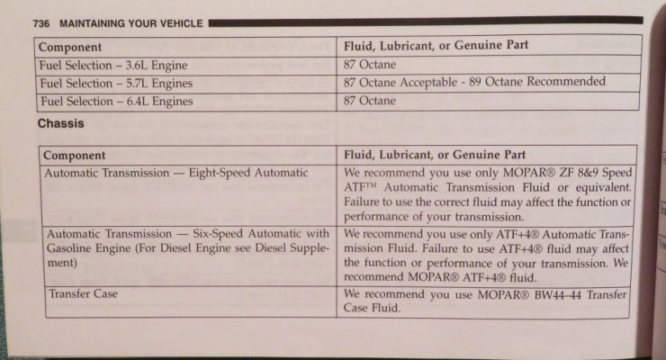

The 6.4 has been the same compression ratio from when they introduced it in 2014.
I know my big 700 page manual for my 14 says only 87 for the truck 6.4,and doesn't say anything about using 89.
Yeah, but you're in CA, remember there are differences in fuels and such?
Anyway here is the screen print from my 2017 2500 with 6.4L Hemi. Unambiguous as I stated -

To be honest, the owners manual seems to be ridiculously unreliable, changing it's mind more than an angsty teen.
Between the changing octane and oil requirements from year to year, its safest to just follow common sense and put the best stuff in we can find at all times. So minimum of 89 for octane, and 5w-30 for oil.
