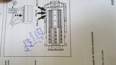

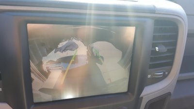

Got my back up camera installed !!!! Thanks Rick! !!!! Instructions suck !!! We use a scotch lock on the orange and dark blue wire that goes to the BCM ...we removed the seat alot easier to get under there with seat gone .... juss 4 bolts an seat is out ... took in total about 4 hrs and we ran in town for for the scotch locks ...here's a pic ...

Pic...
This pic shown in the instructions is the back of the plug not the front ....fyi.... again thanx Rick couldn't of done it without you
