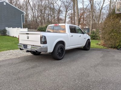

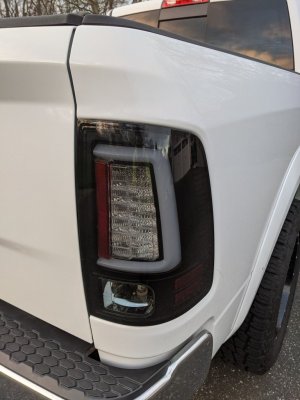

Smoke model delivered yesterday, only installed 1 in the dark last night. They are bright! Only thing i noticed is i can see the mounting clips on the side, need to see if i can do something about it.
My box didnt come like yours, only a warning label said spyder auto, made in Taiwan.
Now i need a 3rd brake light!
