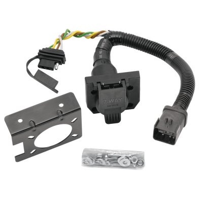

As many searches as I have read through, I've yet to find an after market harness, or preferably the identifying terminal, to pin into the existing truck supply harness?
Anyone find out the type of terminal pin used in this harness at the factory connection?
Confirm these are Apex 2.8mm terminals?
Here's why I ask
2003 Ram 1500
I have the full 7 pin setup, but it ends at the underframe connection behind my driver wheel well
Truck has the factory installed fuses and relay, the installed factory harness connection. Yet they finished it off with 4 pin harness?
Did it really save them money to stock both 4 pin and 7 pin on the line?
Like many, I installed a 7 pin connector that uses a 4 pin adapter with 3 loose pigtail wires. I ran a dedicated 12 gauge wire from the blue trailer brake wire at harness connection, to wire in my added 7 pin at the bumper.
