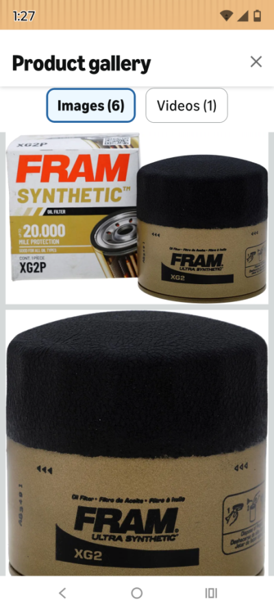

Speaking for myself, and maybe others, I would like to see a list here of perfered filters, even filters that have got/getting axed (maybe people can find them still sitting on some store shelf). In my search the Purolator Boss filters seem to be a USA thing???
But I have found the Fram XG2 filter still up here on shelves.
Also, on Frams site there are 2 other premium synthetic oil filters, are they as good? (This info may be on this thread, but I think it would be a journey to find, up to a few pages now)

Good idea ill try and help!
Current favorites that I would recommend are
1)purolator boss 24651 is the bigger srt filter
2)carquest EP 80372
3)fram ultra xg2 get em while you can since they went bankrupt due to first brands ownership-this also affects other filters
4)fram titanium fs2 same goes here
5)wix xp 51372 and 57899-same size filters but 51372 has higher bypass pressure
6)mobil 1 210a-well made synthetic blend filter.
7)fleetguard lf16002 awesome choice with high efficiency 100% at 24 microns IIRC
Old favorites
1)royal purple 20-820-if you can find them get them, however ive recently been made aware of a "ruffled leafspring" issue in these and other champ labs made filters. The issue prevents proper sealing of the bypass valve so it may operate in partial bypass all the time. No way to know without cutting it open but it began to pop up in 2025 for sure maybe 2024. Champ labs is bankrupt as they to were owned by first branda
2)amsoil eaO11-same as royal purple, amsoil is currently looking for new suppliers, stay tuned
3)fram synthetic endurance fe2-amsoil/royal purple filter with fram label-same issue as the others
