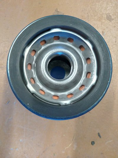

Fwiw, my HEMI's oil psi while using the AMSOIL AEO11 compared to the Royal Purple 20-820(s) at idle and driving are identical:
Cold start up idle - 56psi
Hot idle -48psi
Highway/Interstate driving at 70mph -53psi
So, the difference of the amount and size/amount of the inlet holes on the baseplates didn't make any difference, as to the oil psi. in my HEMI.
My HEMI is a little over~48,000 miles and had the occasional dry start up valve train clatter before using the oil and oil filter combo of Red Line 5w/30 oil and Royal Purple 20-820 oil filter. Maybe I'm fortunate that this combo has resolved that issue early on and by doing so that may reduce the possibility of the lifters/cam from imploding.
I have a couple of Royal Purple 20-820 filters ready for future oci's, but I may try the FRAM FE2 oil filter and see if there is anything different ... Imo, I think it may do just as good as those other two filters.

That would be a cool thing to try - and hopefully report to us. Pressure should be the same if these are clone filters.
Even more interesting would be to try the near equivalent size Fram Ultra XG2 oil filter, which has higher flow restriction media - to see if the EVIC oil pressure changes. For a true constant flow gearotor oil pump (constant flow, variable pressure), it should not. Yet we have seen some strange differences reported by members.

I could also try the FRAM XG2 for arguments sake ...
Hence my thinking on the true constant flow gearotor oil pump, curious, why did @Burla, using one type of oil filter vs another made his HEMI tick ... maybe the anti drain back valves were/are different or the center tube inside the oil filter was restricting the oil flow due to one design being "holes" and the other being louvered/slits or the base plates having less/larger inlet holes?Idk.
