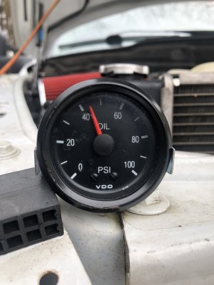

I put a mechanical gauge on truck
When it starts oil pressure goes up to 30psi then drops to 0 over 2 minutes

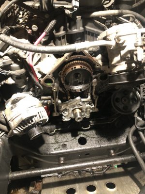

I took oil pan down to check pickup screen, all were pretty clean
If your truck is lifted (suspension) the oil pan comes right off
So only other thing left was the oil pump
And that was it, replaced it with Melling oil pump and now I have 43+- lbs at idle and up to temp
You will need to change water pump gasket, thermostat gasket, timing cover gasket, crank/timing cover seal

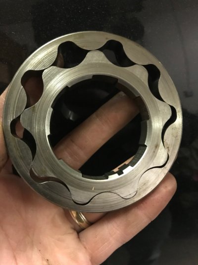

The oil pump was probably scored up inside. I had some engine damage and this was the internals of the pump f432ebe3acd3bc294539b25900e8ec65.jpg

You WILL need oil pan gasket, timing cover gasket, water pump gasket and crankshaft/timing cover seal , all that stuff has to come off to get to the oil pump, pretty much entire front of the motor has to come off, removing the radiator and trans cooler, power steering cooler etc is By far the easiest way. Also autozone rents a tool to pull crank pulley off, I think it was $80 that you get back when you return it
The only thing I changed that was optional was the thermostat gasket, but since everything’s tore apart anyways might as well replace it, 5$ part
