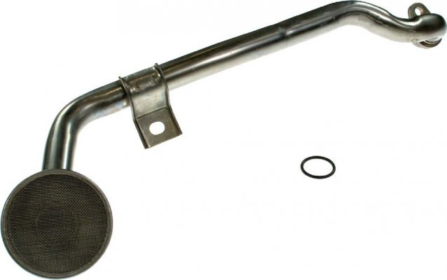

Damn. It could be the oil pump itself too. I'm skeptical that the main/rod bearings are worn out because when my truck was new it would dip down to the mid 20s at hot idle. I'm suspecting either the oil pump itself of something blocking the pickup screen...

What you are trying to clean with the Seafoam.......gunk/buildup on the screen & around in the oil pan

As to low oil pressure, I think the suggestion that the pump pickup screen is restricted is a logical cause, partially because of the mileage, the fact that it was a fleet motor, and the fact that oil pump failures on Hemis is not a common occurrence. This deserves a compression check.
