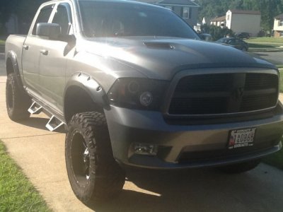

not a 2014. But I've got 20x10 wheels w/6" lift
