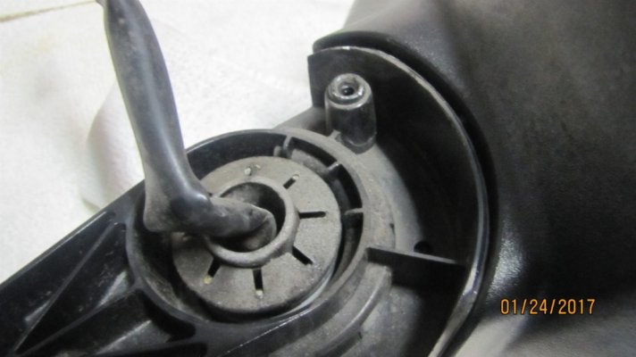

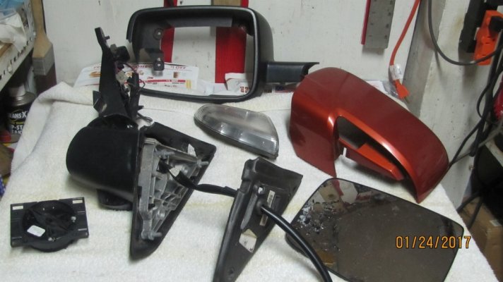

Look closely at the mirror where it it almost touches the door
I have not taken a electric folding mirror apart
If i recall, there is a small plastic panel that comes off
that may be an access panel for the pivot point
This is a 2009 Ram manual folding mirror
this looks like the pivot point
you can see the wires coming out of the mirror frame below
