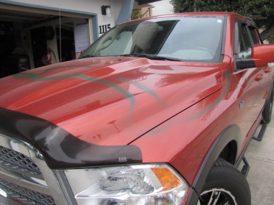

After washing up the truck I noticed that there was tiny yellow specs on my bumper and some of the plastic on the front of my truck.
I realized it had to be over spray from a road crew painting the road during my trip over the summer.
Any tips on how to get this off? Thanks
