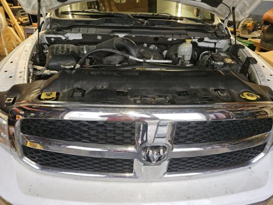

Update:
I did not get a chance to continue with the truck last night, and my serpentine belt and grille clips are due to deliver on 1/15. Going to wait until then to finish.
It will be interesting to see what came out of the reservoir since it was so dirty, it should be separated well by tomorrow.
When I was rinsing it out with the light distilled water/coolant, I spilled a little on the concrete, and it left a tan stain. I didn't mess with it.
Possibly casting sand? I should've taken a pic of the stain.
Stay tuned.......

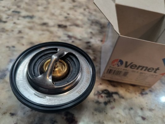

Just adding this info in case someone in the future finds it useful.
I got the two CalorStat 192* thermostats that I ordered from Rock Auto.
The box says "made in France".
The most accurate temp probe I have is the remote probe on my Innova 3340 Pro multimeter, so I used it to continuously monitor the water temp when I tested them.
I put them both in a pot of warm water next to each other and turned on the heat. At about 191.5* they both started to open at exactly the same time, and took about 25 seconds to fully open. At the point they were both fully open, I turned off the heat and monitored them while the water cooled.
They both stayed fully open until about 192*, then both started very slowly closing as the water cooled. Both were fully closed by 170*.

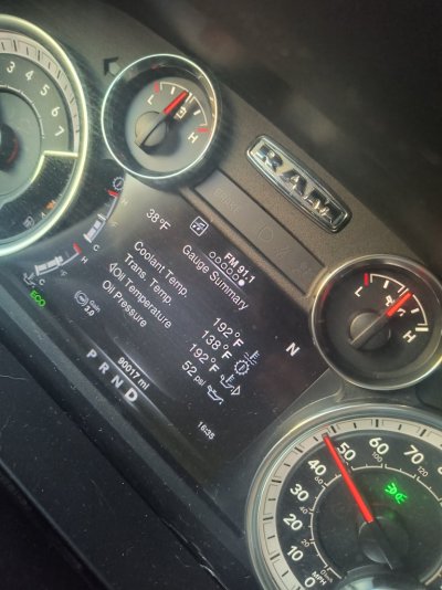

So, I installed it in my truck and went for a 15 to 20ish mile driven while monitoring the temp on my Evic. It went up to 195 pretty quick, then when the thermostat opened, it dropped down to 190. After a few miles it stabelized on 192* and stayed there:
They gotta be better then anything Motorad builds,lol. Keep us updated on them long term Ken,as alot of new thermostats test good when new,but 6 months down the road they go south

Ken do have a pick of the thermostat and gasket.When i hunt it up on Rock Auto it shows a totally differant gasket then what the hemi uses,thermostat is a bit differant to.The 180 looks right,but the 192 not so much

Well I had a bit of a struggle getting the coolant filled on mine, but she is done, yay!
Thank you to all for your help and encouraging words, that's what makes this site so awesome.
