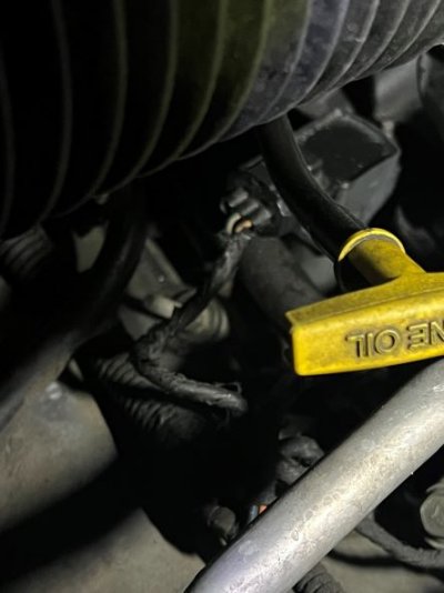

I recently purchased a 2003 Ram 1500 with 168,000 miles.
This is meant to be a beater that I purchased very cheap as is, the owner gave me a paper from an innova OBD2 scan tool that showed a code P0308, with a recommended fix of "repair engine wiring harness".
The truck starts and runs but it smells gassy. After replacing the battery I used a cheap chinese scan tool that I got off amazon and now I have P0172. I imagine the P0172 is just a generic rich code and the scan tool I have is just giving surface information, so its possible it will eventually throw P0308 again. and that is a more specific code related to the problem?
I checked the air filter and then went to clean the MAP sensor and noticed it has a wire missing
At this junction I'm assuming it's just running without a MAP sensor reading.
Would it be possible to just replace this specific connector, or would this indicate I need a new engine wiring harness?
Open to any suggestions as to where to start.
Thanks!

The thing your showing in the picture is not a map sensor thats a coil has right amount of wires. The map sensor is in the front of the intake manifold behind alternator/ac compressor near coolant temp sensor. I would have someone check out the live data when its running with a real scan tool 02 sensors map ect is the truck missfiring at all?
